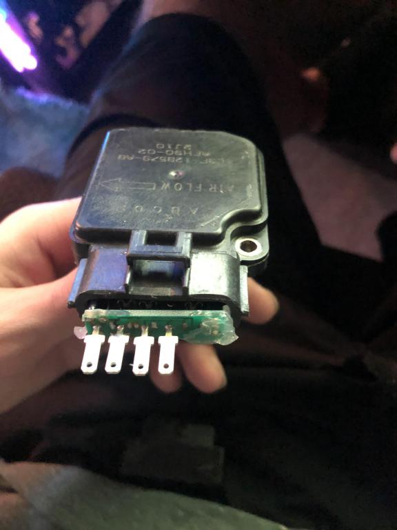

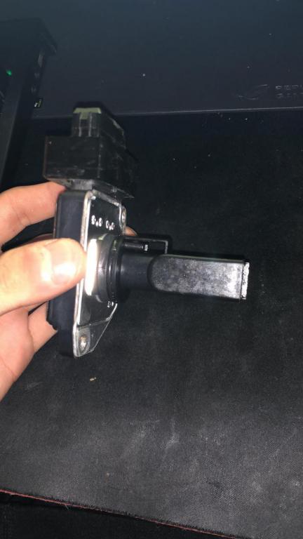

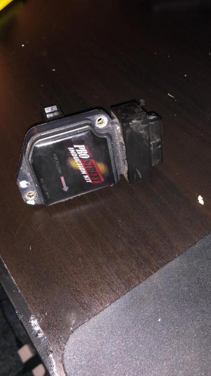

    So I tried getting a replacement maf from brody he told me the replacement sensors are 200$ and could be ordered thru email. Told him I'd like to order one and I never got a reply.
    Does anyone know what type of sensor this is? I'd like to source one myself if possible. Thanks in advance

    I'd peel the Miller sticker off and see what you find underneath.
    Hopefully there will be something there, and hopefully the connector is the same. Kind of looks like it's been adapted to fit the AFM plug?

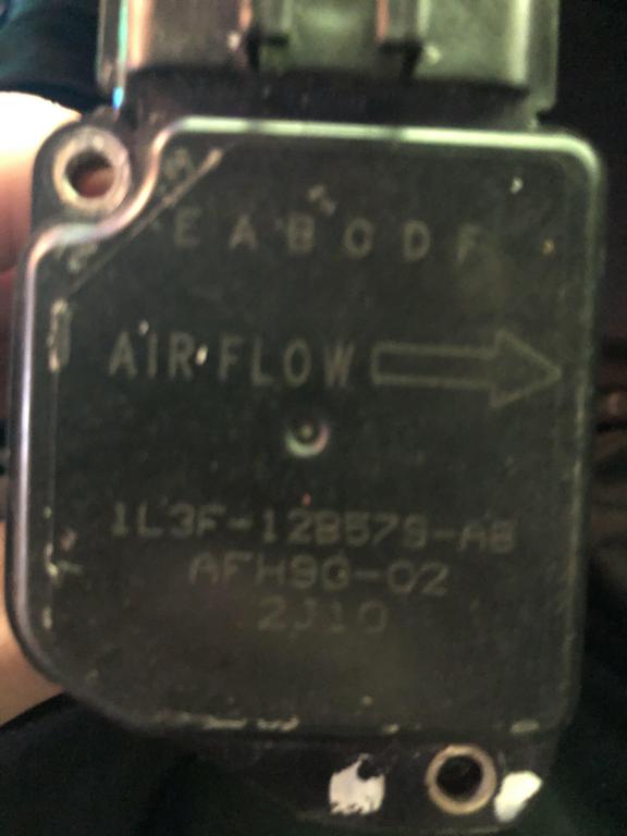

      I can't believe I didn't do that sooner lol. Thanks for the help. It's a Ford Racing SVT Lightning 90mm Mass Air Meter. People use them on mustangs and f150s. I ordered one for 50$ on ebay. Here is the link if anyone is interested https://www.ebay.com/itm/224357033493
