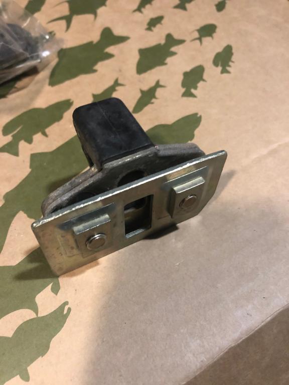

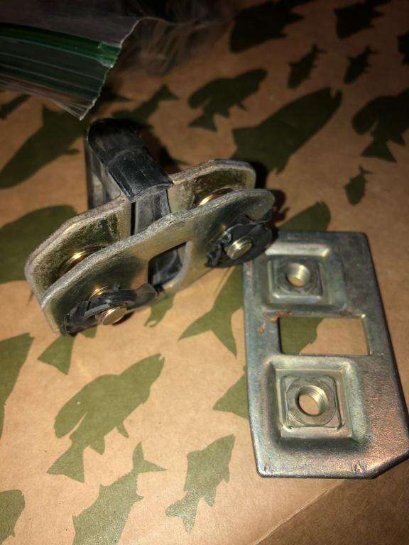

    What is the stacking order of the door striker latch?
    I'm currently rebuilding my e30 after a respray and thought I took a detailed enough photo of this area, but I'm a bit flummoxed when I compare it to the realoem technical diagram: Could someone provide me the stacking order of the striker plate, washer plate, nut plate and grommets for the door striker assembly (including where the body lies in the order of that stack?)
    I've checked the manuals and can't seem to find anything specific.
    in the order and orientation as shown. grommets seal holes from outside and the threaded plate goes on the inside.
