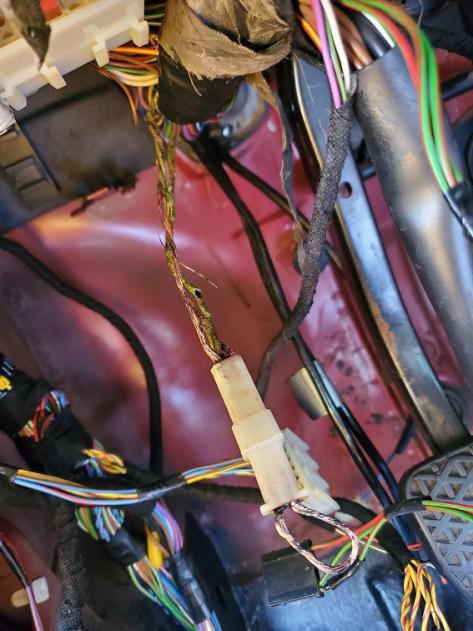

                            • Dzdimi14
                              • Jan 2015
                              • 158
                              Dont worry I am still here!
                              Car is up an running after a year or so of tribulation! I basically started the process of ripping apart all the wiring in the engine bay to see what was melted and what wasn't. The culprit ended up being a result of my own stupidity but not what I had initially thought! My drivers side wheel well plastic was hanging off and the original attachment point was snapped so I screwed in a tac screw right next to the original mounting point. But, in my youthful stupidity ended up drilling straight through the wiring loom leading to the abs. This is what caused my short and fried a bunch of wiring in the car. I followed the wiring from that point down to the battery and replaced all the wires I saw with any sign of melting. This finally got the car running but only two weeks later my starter was getting weak and only intermittently working. Considering I had just replaced the starter (with a shitty knock-off non bosch) I thought the problem still had to be with my wiring debacle. This caused me to spend another 6 or so months replacing bad grounds and whatnot with no avail until I finally bit the bullet and decided to replace the starter again this time with a proper bosch unit. Finally the car runs! Not perfectly though, now I am having a strange problem where my revs start jumping around 1 to 1.5k when coming off throttle which I need to diagnose, but at least I can drive!
