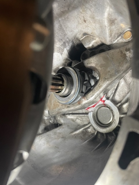

              SOLVED: Took about an hour to separate the transmission from the block. Took another hour to get it far enough back to be able to see inside. That metal gasket hung up and killed some time.
              This is what I found:
Name:	x1VYJPFVEmDNiE5A5adchd6jhOiA69HK2lCbBuTZB-cPuEfUZBx5d-T_2PVAQee4pP0-maGLS1rifj9ZUy41KmOleOXC9AcFggpSN26FIhDoMgNiPk3HseONcuteYee_wplLzO-zzw=w2400.jpg
              As you can see the throw out was indeed 90 degrees off, allowing it to sit further in the carrier arm and thus letting the carrier arm hit the pressure plate.
              Took another 2 hours to put it back together, the stupidest things slowed me down.
              Truth be told, I can still make the grinding noise but only iff the clutch stop is removed and the clutch pedal allowed to hit the literal floor. With the stop in place, even at lowest position, no grind.
              ~Jason
