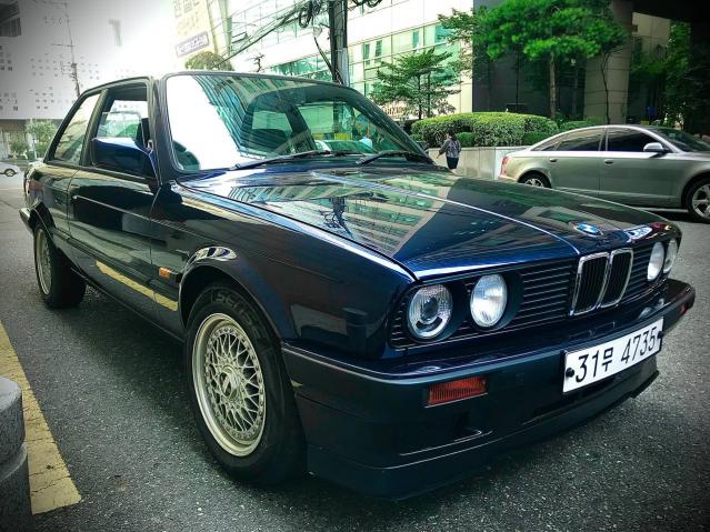

    pic of said piece of shit: Click image for larger version  Name:	2022-09-28 00.24.02.jpg Views:	0 Size:	70.0 KB ID:	10069757

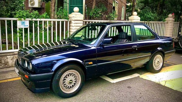

                    edit : gorgeous car btw.

                      thanks, hopefully i can get it sounding gorgeous too..
