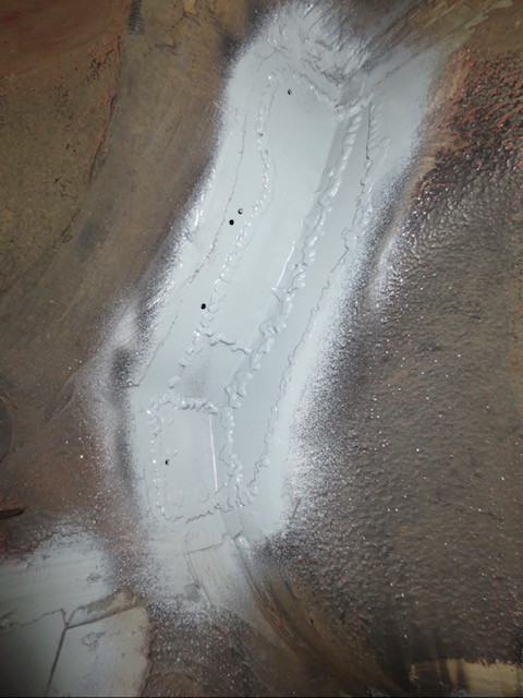

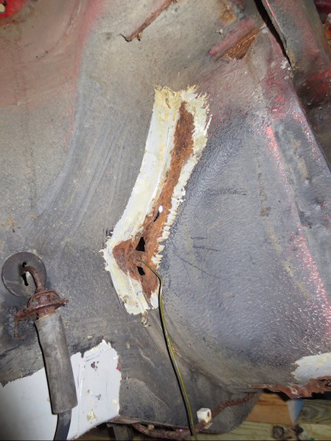

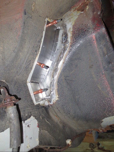

        As the others have said, anything can be saved. It’s only metal. But it would take time, tools and a little skill. The repair for your first photo is easy. It was the first area I fixed on my car. Not pretty, but strong.

          Just replace the front crossmember with a clean used part. Need to determine if the rust on the frame rail is just “surface” or “cancerous “ rust. Brake lines look like it needs replacement. So what you’ve shown might just be the tip of the iceberg. But it’s all fixable.
            nice job.
