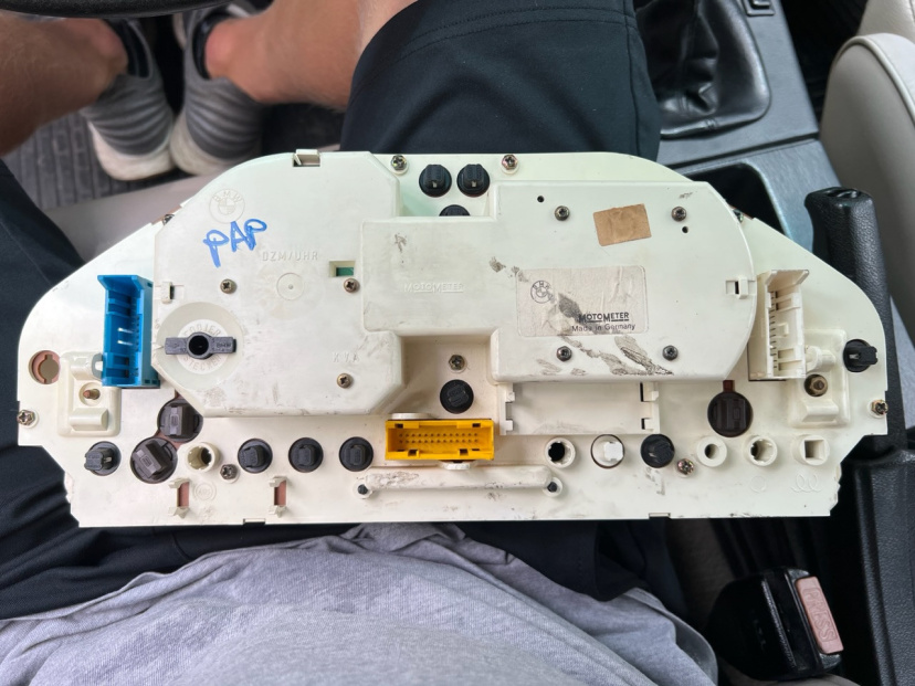

                  I determined that my cluster is Motometer and the speedometer itself is VDO, if that matters. Here is a photo of the cluster rear.

                    Originally posted by acarpenter86
                    I’m definitely interested in the part you have. It would be great to get this thing working.
                    That is an older unit. I have put the odometer from an old unit into an newer one and vice versa, it works. I have also mixed up motometer and VDO, with no issues. I vaguely remember something about matching tachs to the new/old style, but speedometers did not matter.
