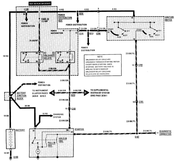

    Ever since I got my new-to-me E30, I have been able to start it without pushing the clutch in. Seems very suspicious, so I looked at the wiring diagram and saw this:
Name:	start wiring.jpg
    If I am researching correctly, the Black/Yellow wire is the wire that actually triggers the start solenoid? If so, does that mean that the Factory never had a clutch interrupt switch for starting the motor?
    Also, what exactly does the Black/Green wire do? What is its purpose?

      The diagram literally says exactly what the black green wire does.
      Why would anyone need or want a clutch safety switch anyway? If we're responsible enough to drive the car, we're responsible enough to make sure it's in neutral or hold the clutch down while we're starting (which isn't great for the car anyway).

        Yes I see the diagram shows that wire provides voltage to the unloader relays to deenergize them. My question is - why? What do the unloader relays do? Why are they needed? If that black/green wire was not hooked up, what would happen?
        And I agree, I always do the neutral shake and/or push in the clutch when starting anyways, but I am trying to get this car as factory as possible and wanted to make sure i didn't need a clutch safety switch.

          I don't know if it's the same on your car, but the unloader relays typically cut power to accessories like radio for cranking so the starter has everything available.
          Not one E30 I've owned has had a clutch switch for starting. It's a good thing IMO, not great for thrust bearings being loaded up with no oil behind them.
          (clicky on piccy to get to thread)

            Alright that makes sense, good to know, and never thought about the thrust bearings in that way, thanks!
