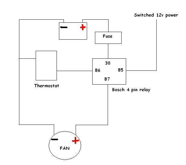

                      I have been using the $70 14" fan from autozone/pepboys/advance auto on my DD (which is now m50 powered) for about 5 years and on my track car (m20) for 2 years with no problems. I used the $20 thermostat kit that they also sell.
                      I have mine wired as follows:
                      -12v switched power goes to pin 85 of a 4-pin Bosch relay
                      -Pin 86 of that relay goes to the thermostat, and the other pin on the thermostat goes to chassis ground
                      -Battery power goes to pin 30 of the relay
                      -Pin 87 of the relay goes to fan positive, fan negative goes to ground.
                      Make sure you use a 30-40 amp fuse in the battery power, and a 1 amp fuse on the switched power. For switched power, I spliced into pin 87 of the main relay on the engine harness.
                      I make no guarantee to the reliability/logic behind this setup, but it's worked for me for a while and seems like it shouldn't hurt anything.
                      Here is a quick pic I made:
