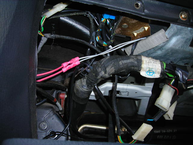

      Originally posted by n0m4d
      I spent sometime looking over the problem last night and this is clearly one of the troubled areas. I do not have anything connected any of those connectors that come out of the DME harness. There are 4 connectors, a BL/GY, a RD/BL, a BR/RD and a 3 wire BK/BL, GR, WH (or WH/YW?).
      The OBC harness was cut about 2' back and I think the 3 wire connector came from there so I need to sit down with the ETM and figure out where to reconnect them to. There doesn't seem to be corresponding colors downstream of the OBC harness. The green is switched power but I don't know what the other 2 are.
      I think the BL/GY is the ebrake sensor and the RD/BL is the Park/Neutral so I'm not as concerned about those. I don't know what the BR/RD connector goes to.
      Another concern is the lack of switched power in the harness. I assume most of the green wires in the harness should show 12v when the ignition is on but they don't. I'm concerned that the instrument cluster (which does get power w/ ignition) was necessary to trip a relay somewhere.
      Anyway, since you guys were so helpful I thought I'd update you :).
      I found just the pic for ya.
      The unplugged connector in the bottom right of the pic is the three pin connector in question, coming out of the DME harness. If you look in the upper left of the picture, you will see another three pin connector that is mated. Disconnect the upper left connector, and mate it with the lower right connector.
      BTW thats some top secret shit right there. Shhh. Can't let the car thieves know bypassing the 80s anti-theft system is that easy. ;)
      -Dave
