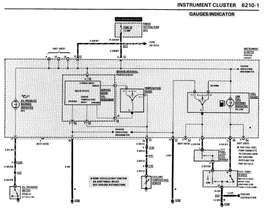

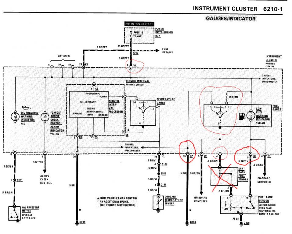

                        #41
                        Cluster should not make a difference according to the schematics in ETM. Try another cluster if it's 100% knowing working good cluster, as it would be the next easiest thing to do. Report back how the gauge works then.
                        I attached 325i cluster circuit and late model 318i to compare.

                          #42
                          I'm gonna take the cluster out the 89 today and try it when I get home, I'll let you know what happens.
                          I'm confused about the 2 circuits you posted, they're the same except the circles and one sender X'd out.
                          I'm pretty tired this morning so I may missing something, lol.
