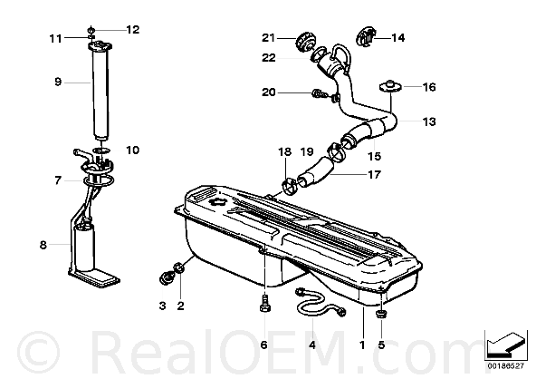

            Just looked on realoem and they're listing ONE fuel sender in the tank?

                is the sender seperate from the pump assembly?
                9 is the only listing they have for a sender?

                  #9 is the thin sender inside the pump, there is also another sender on the other side of the tank..it's about 2x as thick. It's not pictured. Just pull the seat and look for a round cover.

                        Apparently 318is's only had one sender, just checked RealOEM for myself, and it only shows one. Strange. You may have a bad sender then, you can remove the four 8mm nuts on top of the fuel pump assembly and pull the sender from the tank, just make sure to have a bucket ready as it will pee fuel all over the place when you pull it out.

                          318's only have the single sensor mounted with the pump. Unless there is something wrong with the new sensor the gage only going to half way when the tank is empty is caused by the wrong fuel gage being in the cluster. Pull the gage from the old cluster and install it in this cluster. Or go to a dealer and buy a new gage whose part number is correct for this car.
