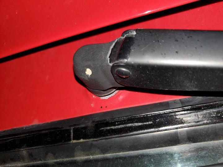

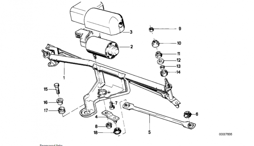

                        The car I recently bought has a loose arm and a few pieces missing. Including this damper ring. I see the parts manual lists all parts. My question is the order that these are assembled.
                        Please see below. I assume the Wiper Arm goes between items 9 and 10 and that 13 is under the car body and 12 above?

                        • Westija
                          • Aug 2015
                          • 90
                          I saw that the Damper Ring is the one that has a channel on it where the body plate is supposed to go into. I had a hard time to insert the Damper Ring properly in there , but it worked.
                          I want to post a picture of the back of the left had side plastic grill, so people can see where the clips are and hopefully help not break it when removing it. There are three metal clips at the bottom and a few plastic tabs on the top.
