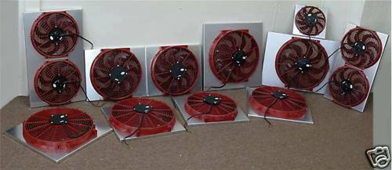

                    What make/size fan are you using behind that radiator?
                    • dude8383
                      • Jan 2005
                      • 10387
                      #55
                      It's an FFD 12" fan:
                      I have this guy up front mounted on condenser:
