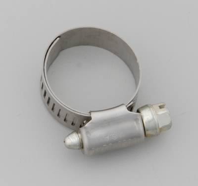

            I should have shown you my rad at the picnic. I had the same issue initially with my mishimoto rad. I think you might be able to gain the clearance you need if you ditch the BMW hose clamps and use cheapo generic stainless clamps like this
            The reason being on the bmw clamp the "threads" if thats the right word are raised off the band. The band on the regular old autoparts store hose clamps are flat and you should be able to fit two of them on there.
