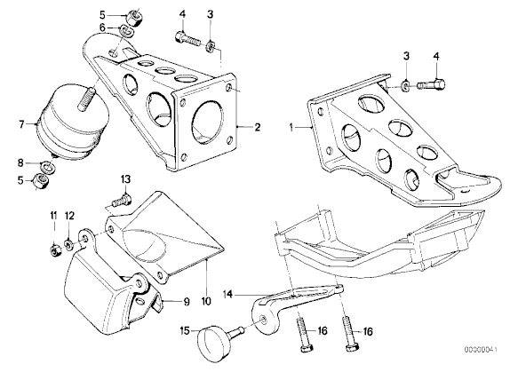

    What's the best/safest way to lift the engine on an E30 325i?
    Lift at the each engine support bracket on either side? And if so, what's the recommended way to connect to these?

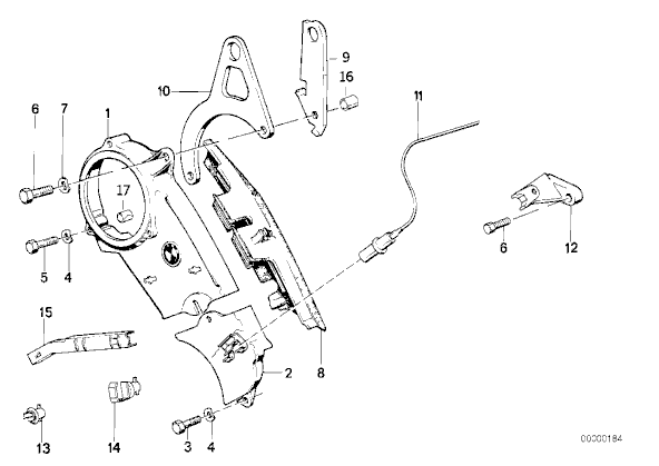

    OR lift at the front engine lifting bracket?

      Thanks to m-technik-3, it was a cinch. Would also recommend the engine bridge thing a ma bopper.
