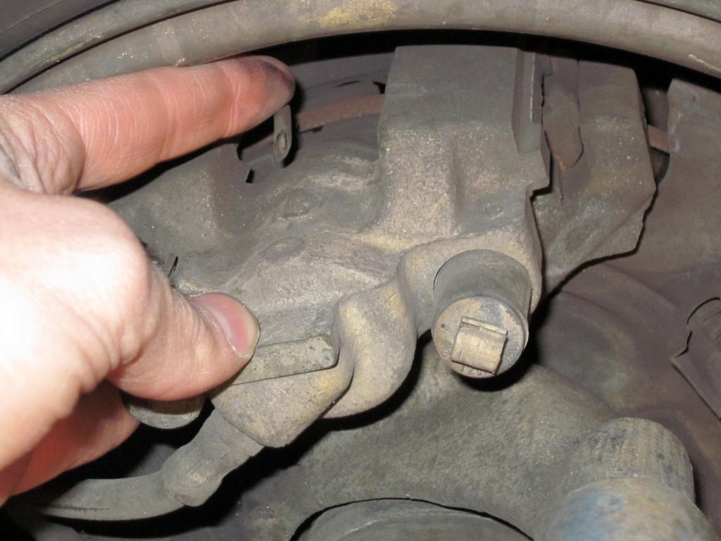

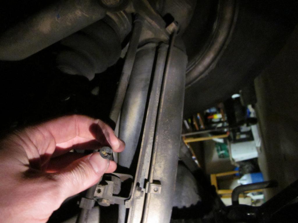

    My ABS and brake lining lights are on due to some torn up wires under the car. The connector for the right rear pad wear sensor came out of the holder on the backing plate and got torn out along with a piece of the harness.
    My bentley manual doesn't include any info on this part of the wiring and an hour or so of searching hasn't done me much good. Does anyone know where these three wires are supposed to go? It seems that two wires go to the sensor but what about the third?

        best i can tell from my diagrams...blue/white and green/yellow are your wear indicator wires. left hand rear speed detector is green. hope this helps.
          sweet, i'll have to get under there and do a little digging. Those two bright ass lights on my cluster are getting annoying haha.
