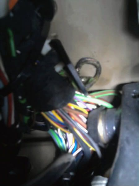

              I found the wire a few days ago, its green! haha. It goes through the firewall down to where my knees are, its all melted and shitty looking. Whats odd is the car runs just fine now. My brother is a BMW tech, so i am just going to wait till he is back from vacation, his specialty is electrical work, so it should be pretty easy for him :)

                Um green? Is it a bigger gauge than the rest of the wires? If so, that ain't good. That green wire provides power for quite a few things, the ECU being one of them. Do not drive it in this condition, you're setting yourself up for a shit storm that could result in a fire.
                  If its a very small guage green wire it may be the one that comes from your starter and goes to the abs light in your dash and the abs relay under your dash. Did you put a new starter in recently?
                    im betting its the power wire to the window switch.
                    AWD > RWD
                      That green wire sounds like it might be the "Hot in Run and Start" lead from the ignition switch.

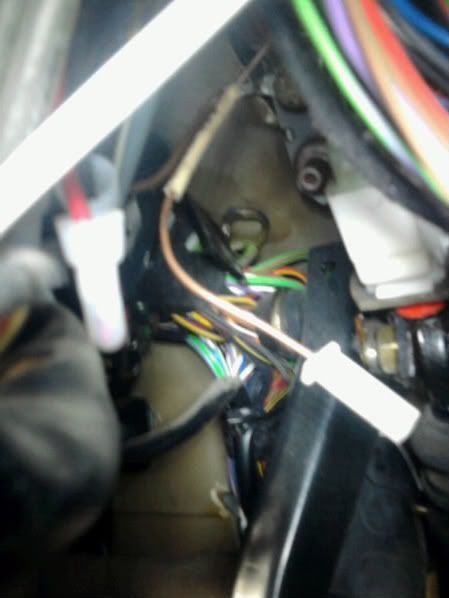

                        Sorry about the not so good pictures, they are off my phone. So as you can see, its that odd wire that is in a bit of a loop by the top of the clutch pedal on the left side of it. It looks brown now, but when i look close, i can tell it used to be green.

                          can you follow it to see a place where the original color and tracer are apparent?
                            I have tried, but everything is to tight. Can I just cut the black tape (almost like hockey tape) to loosen it all up?

                              yes you can, easy to replace later. Another option is to disconnect your battery ground and then power lead, and cut the wire. You aren't gonna want to leave that in there anyway. If it goes to the engine compartment ( make sure first ) have a friend go to the engine compartment while you push the wire so he/she can identify which one it is and pull it through, then just follow by hand to where it goes. You'll also have to follow the other end to where it goes.
