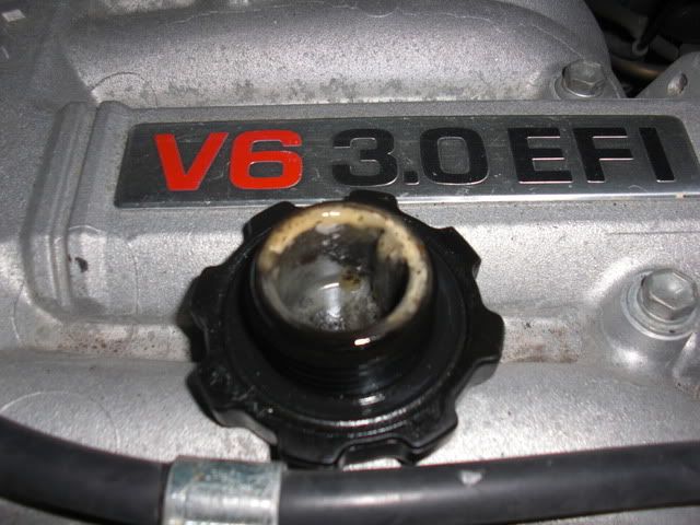

    Check for a bad head gasket. A quick (but not always reliable) check is to look for chocolate milk /milkshake under the oil cap (water mixed with oil).
    Check the coolant and see if it looks dirty/muddy.
    This isnt always a sure sign of a bad head gasket since oil is hygroscopic (absorbs water) and an engine that hasn't reached operating temperature can have a milky oil cap due to condensation that hasn't been evaporated by a hot engine. Also sometimes oil coolers can fail and allow oil and coolant to mix, but anticipate the head gasket being bad since that is the more common occurence. You can also check the compression and will see a large drop in compression on one or more cylinders (likely adjacent cylinders if the head gasket failed between them ). Has your engine overheated or been running hot recently?

        yeah I though it may have been a head gasket on first thought as well, checked both oil and coolant though and no mixture... I was gonna do a compression test tonight but alas I didnt make it home! and no I have not been over heating at all.
