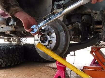

                  Sagaris, any suggestions on stabilizing the hub while I turn? Also, I understand what you are saying, but not sure why it will work. I snapped a bolt head trying to turn it with a socket with the tire on the ground. I had great grip and leverage. Why would vice grips work? Is it really that the bolt head seizes to the wheel? I thought the threads are what is seized. Thanks.
                  • Sagaris
                    • Sep 2009
                    • 2243
                    Thread two of the lug bolts into the hub and use a bar in between them to hold the hub still. Think of a percent symbol % as the heads of the 2 lug bolts then the bar in between them. The threads seize but when a lug bolt is over-tightened, the yielding occurs at the base of the head just before the threads start. This is also a potential area for stress concentrations to occur. More or less, it is a weak point. Your only struggle should be getting grip on the remains of the bolt in which case I have always had great success with a set of clean vise-grips clamped as tight as possible over the broken bolt. Welding something to it is another option, but not everyone is comfortable with that/has access to a welder.

                        sagaris, will the percent symbol idea work? Did you use a thin rod? I just can't invision the rod bending to get inbetween the two bolts and not get in the way of the center of the hub. The car is nowhere near me right now, or else I would just go out and look.

                          There is definitely enough room to stick some sort of bar between the lug bolts and wedge it still. A jack handle may be too large of diameter for it to work but you should be able to find something with a small enough diameter that is stiff + long enough to get some leverage.

                              Here is a visual of how you could hold the hub still. The yellow handle is wedged between the two wheel studs
