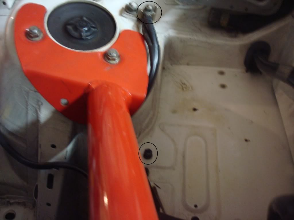

    hey guys what does r3v think of moving the wiring for two grounds from the shock tower to the battery tray, think it will be okay?

          you can relocate grounds where ever you want. make sure it contacts metal, not paint.

                I would say leave it. When I create or replace a bond or ground on an aircraft I measure the results in milliohms. Most of us dont have that kind of measuring equipment at home to measure that low.Another reason to leave it is that you would create a bare metal spot that will rust,and as it rusts,it will create more resistance.
                The existing ground was designed to be a ground,why screw around with it?

                  Do it it will look cleaner without the wire on the strut tower. :0 Shouldn't make a difference. That's where mine is on my swap.

                    Ground is ground. Knock that paint off there and make it happen. Just think, the metal of the strut tower is connected to the metal of the battery tray which is connected to the metal of where the battery ground is connected.
                    It's all the same.

                        Electrons do not care. Cars are not airplanes. Think of all the rust, oil, gunk, and whatever else on the frame. Just make sure that you have good contact and paint over the bare metal after removal.
