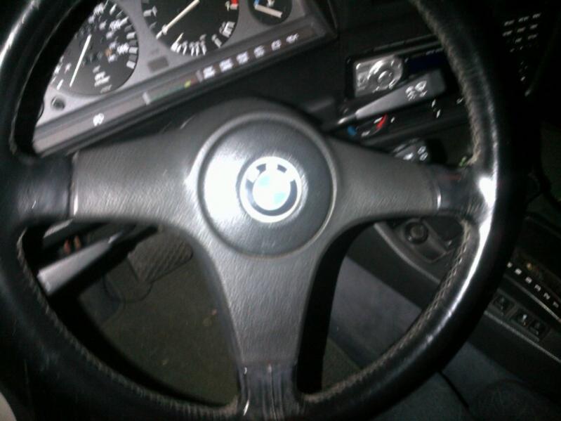

    I have the centre horn ring on a sport steering wheel and I cant find anything that tells me the trick to remove it. Typically you push and turn but thats not getting me where.
    The reason Im doing this is that my right turn signal makes a buzzing sound in the steering column then blows a fuse after 10 seconds or so. Im thinking its a short but of anyone has any ideas on this one too, Id appreciate it.
    PS Its an 89 Cabrio

    An 89 might be different, if it has an air bag, but I think you can replace the turn signal switch after the bottom column cover has been removed w/o messing with the steering wheel.

      I tried that but besides the 2 screws underneath the lower cover there are 2 more on top that you cant access with the steering wheel in place. I actually just came from PullApart where I tried to salvage a turn signal switch, but couldn't quite get it unscrewed with the steering wheel in place so either way the wheel has to come off.
      I did, however, grab a relay which is probably what's buzzing since it also sits in the column. I'm thinking I blew one side of the relay while mucking about with the rear bulb carrier....so Im back to how to get that darn horn button off so I can pop the steering wheel...and no air bag.

        Just remove the steering wheel. Done.

          lol...what is it about "theres a big horn button in the centre of my steering wheel that has to come off (without breaking it) before I can remove the steering wheel" that I'm not explaining.

            that horn button comes off very easily, just pry it up with a screwdriver

              The spring seems to be holding it down so I was just making sure nothing would get damaged. Always best to check before applying force.
