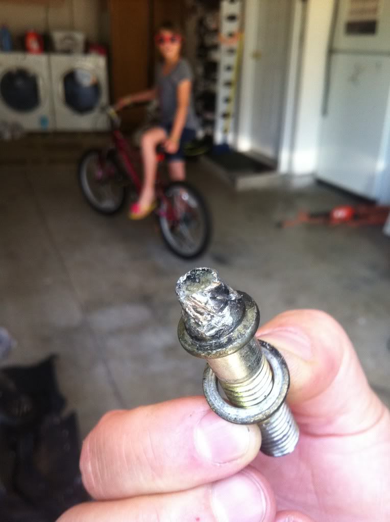

                That's what I was thinking. Ok well I did a test on two nuts with jb weld. They should be full cure by 9 tonight. Ill check tomorrow morning how well it works. I may got get bigger vise grips tomorrow if it doesn't pan out.

                      We spent 8 hours trying to figure out what to do with my stripped top tranny torque bolt and even JB welded it and waited overnight. That didnt do squat. Bought the extracter socket and that thing was out in 5 minutes. Pretty much its designed to where the more the socket strips the bolt, the further down it holds until eventually the nut pops off. This is all assuming your a meat head like me :mrgreen:

                        ^^ I have that set and it doesn't work. It only worked for the first 5. The other five are so corroded that the teeth stripped the copper nut so its round. The next size down doesn't fit. The JB weld didnt work. Im going to try vise grips all afternoon. Ill WIN THIS BITCH!!!
