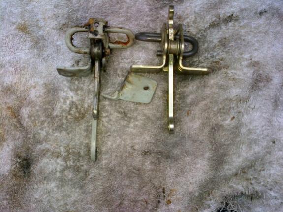

                You may also need a new door brake.
                    Do you have a part number for this? or know where to buy them? My drivers door is in need of a new door brake.
                    • jeffnhiscars
                      • Jun 2011
                      • 6011
                      New they are dealer only & mine cost $30. For PN's check realoem.com

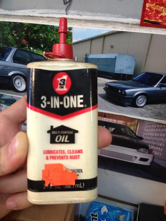

                          I have use 3in1 oil to lubricate this without any problems! Locksmith guys use it.Click image for larger version
                            What's are the signs that these are bad as opposed to just having hinges that need to be lubricated?
                            Newb to all the things.
                            • future rs
                              • Aug 2012
                              • 514
                              Inspect the hinge. The hinge has a bulged section on the arm. Mine is almost completely worn off and the door wont go into the "lock" position. It will just want to swing shut. Inspect the complete assembly. If you see excessive wear or metal shavings it may be time to replace.
