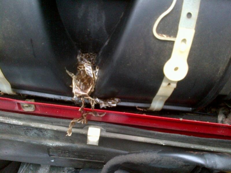

          I went to install a new resistor and found this...no mention of it in the Bentley so I made a key fob from it. It explains why there was a mouse nest but no mouse.
          Alice the Time Capsule
