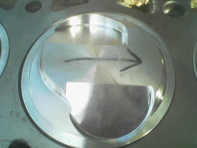

      I just finished installing a fully built race m10 into Terry's racecar 2002.
      Heavily ported and polished head.
      310 cam
      Stiff valve springs, titanium retainers.
      11.5:1 Alpina pistons
      Forged rods
      Knifed crank
      Extended sump oil pan
      Factory sidedraft manifolds
      Dual Weber sidedraft 48DCOE's
      Stahl 1.5in comp headers
      Vac Motorsports LTW flywheel
      5.5in 2 plate clutch with hydro release bearing
      Car is a gutted shell, with 1 seat, a dash, and a cage.
      Car MOVES
