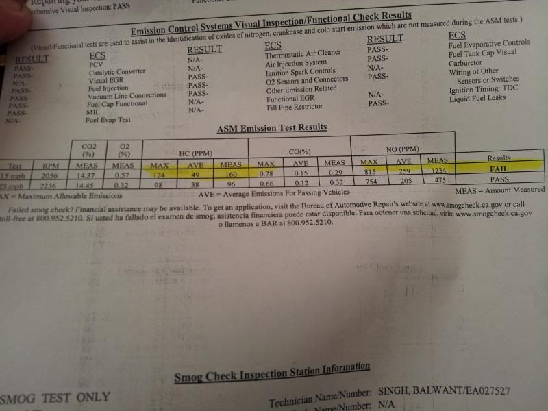

    So my car failed smog today. I just installed a different cat since mine was dead. Cat installed is from a car that passed smog. Hoping to get insights on what to do.

    You need to drive the car harder and really get that cat HOT before you get put on the rollers.

          High HC & NOX can be be from lean partial misfires. In this case, since the numbers are worse at the low speed test the first thing I'd do would be to smoke test the intake and fix the leaks it reveals. If the O2 sensor has 100k (the replacement interval) or more on it replace it also.

              High NOX and normal HC will always be failed catalytic converters. But high HC & NOX can be misfires from lean mixtures. That could also be from bad catalytic converters, but before replacing those you first want to make sure the engine is running correctly.

                      Thanks for the input guys. I will look into all this. I really want to get this car running right. And yes, I definitely feel a misfire on idle.

                            So looks like cat is bad. 02 sensor was replaced, timing is good, vacuum leaks checked (none found), spark is good.
