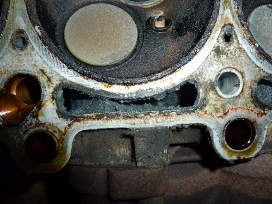

        Before I redid my head gasket, I did the seafoam thing. When I pulled my head there was such carbon buildup and whatnot . . . there is no way that little bottle would do crap.
        A picture is worth a thousand words. Here is my head after seafoaming. Didn't do a darn thing.
