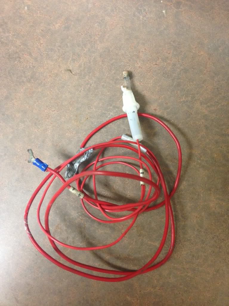

    I have a 89 325ix and I have been starting issues for the past few months. At first I thought it was a battery so I replaced it but problems still continued a few days later. Lights would dim which led me to the alternator. After replacing it, I still have NO crank. I did a quick physical inspection and found this. I believe its the "fusible link" it was not connected to anything on the battery end and had a fuse on the other.
    Would this cause a NO crank? Also, how does one go about replacing this??

    Looks like some kind of aftermarket wiring someone put in for something.

        That wire is not stock leave it out. Check battery and ground connections and cables if your battery tests good
