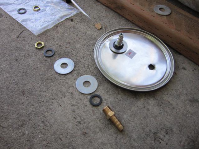

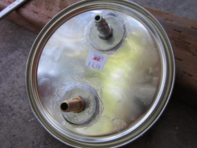

    We used a gallon paint can (new from Ace, $5). Bought 1/4" hose barbs and air fittings, and used electrical nuts on the backside because they're very thin. Used 2 soft rubber washers and big flat washers on each, plus some silicon sealant. Made the holes in the can lid very tight so that the hose barb actually threaded into the sheet metal.

      Some pics of said tester....
      A little silicone, thread the fitting through the sheet metal...

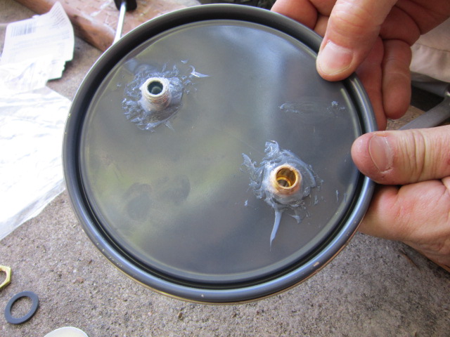

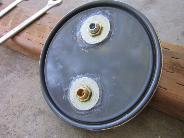

      We actually put the rubber washers under the big flat washers, assuming it would seal better.
