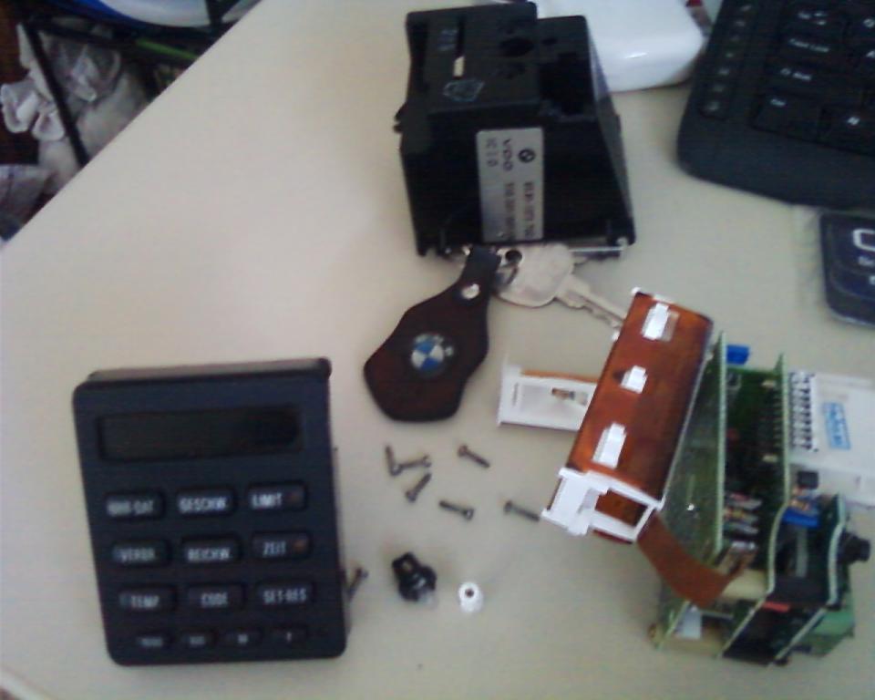

    My '86 325ix (grey market) came with one of the sweet german 13 button obc but the PO stuck what looks like a screwdriver into the side breaking off one of the capacitors or something inside.
    I have a working 13 button with faded letters. Is there anyway I can disassemble it and transfer the buttons to the working american 13 button?
    Thanks

    Yes you can. I did that to mine. Take your time pulling it apart on the one that does not work.

      Can you elaborate? I can't get the front section apart from the rear section. I got the bottom apart but not the top. Also, it looks as if the buttons are wired directly to the pcb board, how do they interchange?

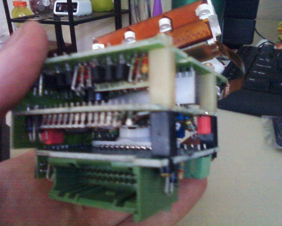

          got it figured out. This thing is intricate! I did kind of snap one of the screw mounting points on the rear but that doesn't really matter if I can take the second one apart the same way. See photos

                The 13 button I replaced was from 10/85 and the one I sourced parts from was 12/85 so everything was exactly the same. I used the coding plug from the 12/85 since that was what was in it when it was working and the button section is the only thing I replaced.
                Pretty easy. Best way I found to get the case off is to start at the bottom. Squeeze the button section together and push down in the very center on the 'brain' section to remove the two clips. Then try to pry apart. After working it loose do the same on the top side of the obc; squeeze the button section together and push in the center on the top to let go.
                A small screw driver in the slit helps too. Slide it into the slit between the two halves and pry down so the screw driver is pointing toward the front of the obc and it shloud pop in half. Then be carefull pulling the button section form the brain section and don't bend the prongs.

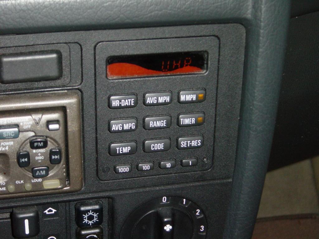

                  I put it back together and it works. Only problem is a few pixels are not visible and my bulb seems to be burnt out.
                  Is the LED screen just not screwed on tight enough or why are there dead pixels?

                    I had the same problem; my screws were not screwed on tight enough; was a pain to take apart again, but tightening the screws made my dead pixels go away

                      So is this a pixel problem or a completely separated screen? Seems to work fine, you just can't see the numbers.

                        I think that is a screen problem. When I took it apart there is glass piece like a microscope slide on the front followed by an orange tinted sheet and then a white plastic strip. I bet the glass is separating from the orange sheet.

                          That's exactly what it is. If it is a dead pixel, such as a bar not showing up, the screen is not fully pressed onto the laminate, and you simply need to tighten the screws to fix
                          If the screen is completely being taken over like that, it is busted for good
