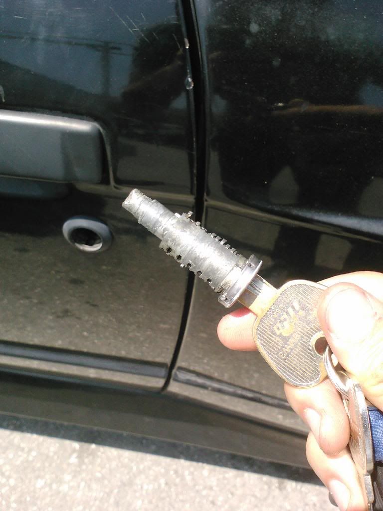

            • mkcman17
              • Jul 2010
              • 8240
              At least this didn't happen to you...
              1989 LN106 Hilux / 3.0TD SFA
              1974 2002tii / stock
              2002 IS300 / 5spd LSD
              • ELVA164
                • 4861
                ^ best security I've ever seen! As a side note, the rebuild kit for the passenger side in a car with central locking is special-order only from Germany. I happen to have one I could sell if you didn't want to wait.
