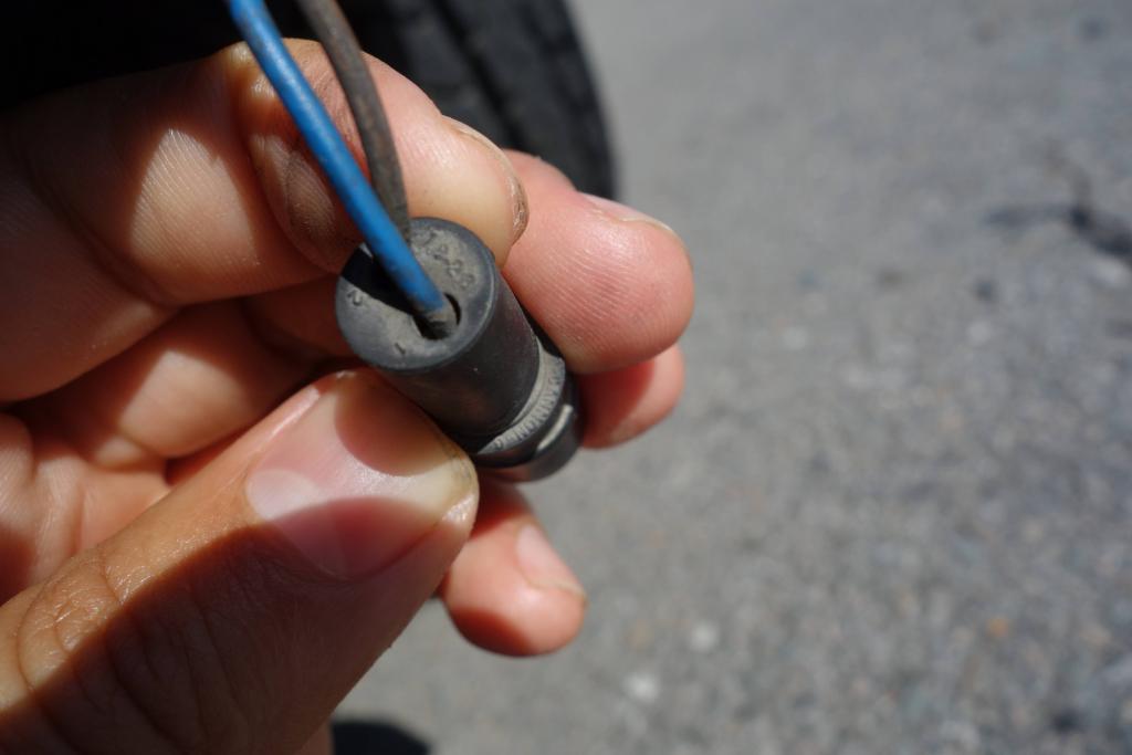

    What is this thing?
    I found this loosely hanging from the front end on the car on the drivers side. What is it?
  • Farbin Kaiber
    Lil' Puppet
    • 29502
    Ambient Air Temp Sensor. It belongs behind the front valance.
    • Mohit
      • Nov 2013
      • 80
      Should I just leave it hanging there?
      • Farbin Kaiber
        Lil' Puppet
        • 29502
        No, you should re-secure it. You shouldn't leave anything hanging, that's just asking for it to get torn off.
        • Mohit
          • Nov 2013
          • 80
          Okay, thanks!

            • Oaklandia30
              • Apr 2014
              • 25
              Hey there, I also have something I can't identify and I hope it's ok to pin it here. It's hanging from the same general location (front driver-side under the valance) and I can't exactly follow the wires back to the fuse box or anything else. Thanks in advance!
              • Farbin Kaiber
                Lil' Puppet
                • 29502
                Brake Lining Sensor Connector.
                EDIT: Oops, I only read front drivers-side.
                  look under car at the brake airduct #5 in link you should find a hole in the side of the duct (if its there) that the outside temp sensor snaps into
                  http://realoem.com/bmw/showparts.do?...65&hg=51&fg=75
                  Angus
                  88 E30M3 X2
                  89 325IX
                  92 R100GS/PD
                  • spdracrm3
                    • Sep 2009
                    • 959
                    that is the two pin connector for the above temp sensor ,your sensor is missing probably ripped off like OP's will be if not secured.... timely post
