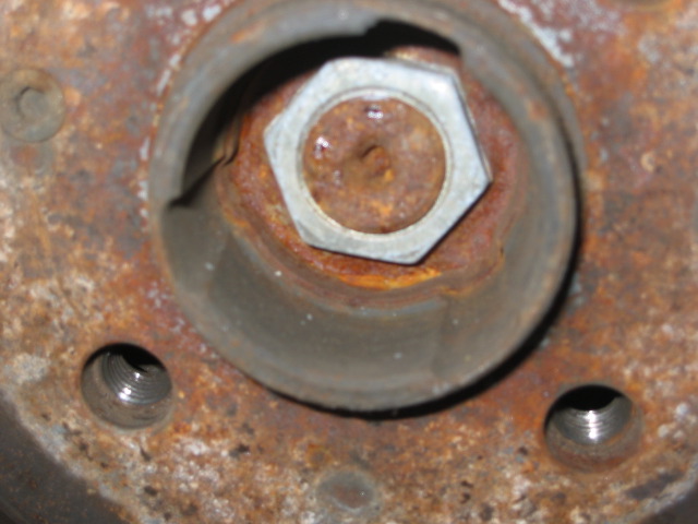

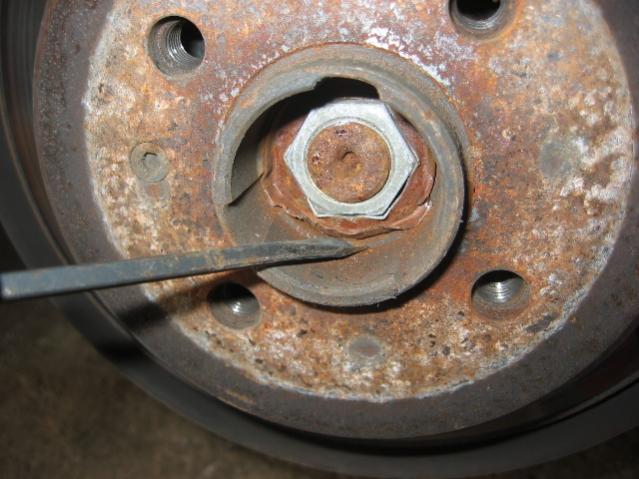

                  Sure there isn't a lock plate? They are actually hard to see sometimes...
                  Pics from http://www.teamdfl.com/bmw/e30/rear_wheel_bearings/

                    Usually if the lock plate's still in there, you don't get the socket on well enough and round
                    the nut.
                    Ask me how I know how to do that...
