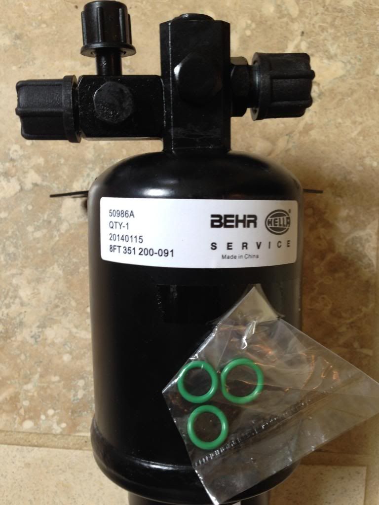

A/C wizards! Need help with Denso system, receiver drier switches

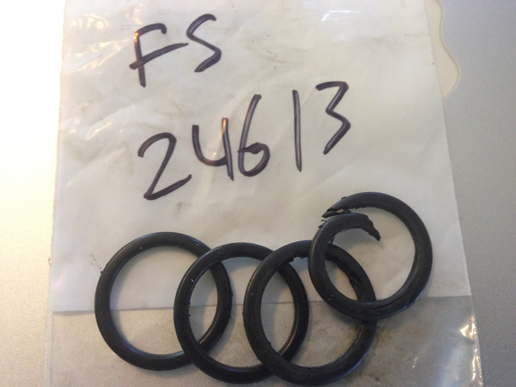

                I wanted to update this thread regarding the O-rings. The ones I ordered were correct and fit properly. I'm glad I pulled those two "connectors" off the compressor because two of the four O-rings (the two on the right in the picture below) were SHOT.
                The O-ring is indeed Four Seasons p/n 24613. I got them at Rock Auto for 30¢ each plus shipping.
                The bolts are standard M8 x 1.25 x 20mm socket cap screws. I got new stainless ones at Allen's Fasteners for 34¢ each.

                  EDIT: shouldn't the 134 "O" ring be green or tan? I've seen blue ones also, color blind anyway. Anything except black in 134 systems.

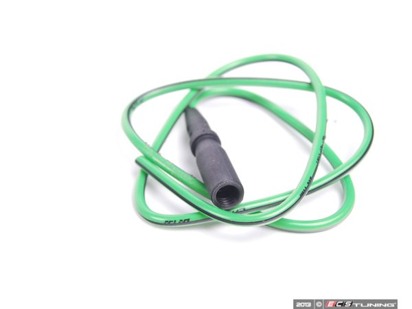

                    One thing that is still not clear is the repair set they mention (1 378 400). The part I have is just the connector with no wiring in it. I assume then I'll need something like this to actually go into the connector, that can then be spliced into the switch harness?

                      No problem, stay cool!
                      like this:
                      The replacements I bought are green (probably Viton). The black ones in my photo were the old ones...and probably original to the compressor I got.

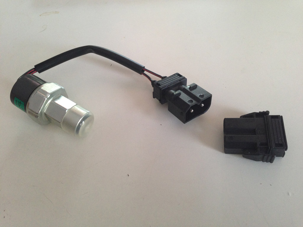

                        You should have this one
                        Reich und Roll!
                        • boy412
                          • Apr 2013
                          • 172

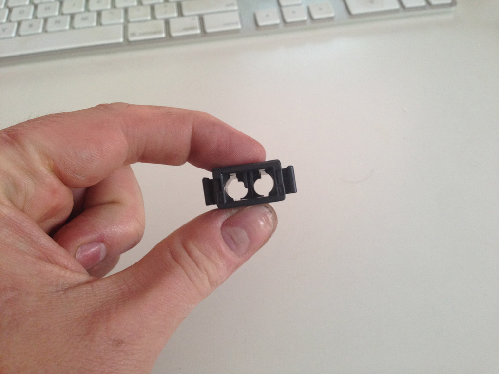

                          Yes...that is the switch I have. AND I have the female connector it plugs into as well...but no wires that actually go inside that connector. Its just a shell of a connector.
                          You can see this connector is just a shell...no female plug inside!
