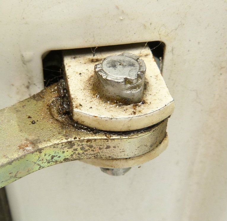

                        unbolt and replace. no reason to spot weld it. you can remove the inner piece, you have to pull off the door lining though. you install the new one from inside the door, and hook the pin to the body.
                        here's what mine did:
