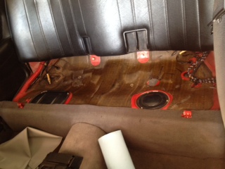

    Started off by removing the bottom of the rear seats which came out surprisingly easily. They litterally just pulled straight out; I'm sure they must have to be bolted in or something because it was way to simple. Help me out I'm a noob :)
    After removing the bottom of the seat, I noticed that it was damp underneath. You can see it in the pictures below. Please excuse the quick iPhone pics.

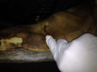

    It surprised me but after cleaning it up I didn't think it was a big issue.

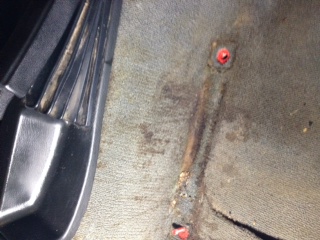

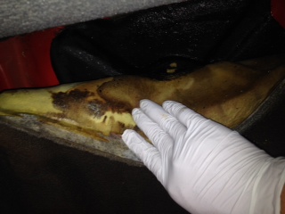

    I then went on to removing the front seats and I lifted up the carpet & heard a watery noise. Let the headache begin.
    Again, damp underneath. I squeezed the foam thats attached to the carpet underneath and brownish liquid came out. I decided to smell it cuz why not and ding ding ding, we have our mysterious smell.
    Here are some more pictures, you can kinda see the liquid sliding down where my finger is pointed.

    Yeah it's pretty gross. I highly doubt that it is coming from underneath the car and soaking into the carpet but who knows. Also the headliner and sides are clean and not wet so i don't think it leaked water from a recent wash or something; ill probably remove those just to see if anything's hiding behind.
    So I'm guessing that the PO decided to explode two bottles of Pepsi in the back seats.

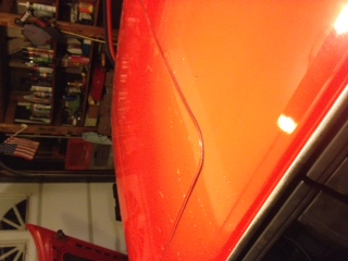

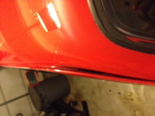

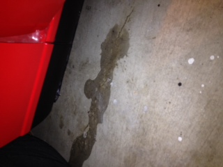

          So i put water into the sunroof drains and everything looks good. Drains down to the floor.
          (Pictures are rotated, sorry about that)
          You can see that there is a lot of dry dirt inside the sunroof so I'm guessing that water hasn't been in there for a while. The water thats in the carpet seems somewhat fresh.

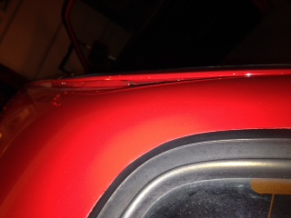

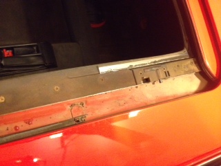

            The PO also resprayed the car (not perfect) and i think that the window trim seems like it is not in correctly. It looks like it sticks out a bit to me but hopefully you guys can let me know if thats normal. Pictures aren't that great, ill send better ones later.
Name:	window trim right.JPG
            However i did put water into that area and all around the window/trim/sunroof and everything leak down to the floor. Looks like nothing went inside the car.
            I'm starting to think that the PO really did drop a lot of soda or something inside the car. Overall I think that would be my best bet right? Better than it being the drains, holes, some oil, or bad body panels.

                              I'm currently working on removing the carpet. Removing the door sills right now oh man those little things are in there tight. I already broke a small corner.
                              I did pull out the carpet underneath the door sills for now but of course I'm going to have to remove them to put the carpet back in.
                              Planning to completely remove the carpet and water the car tomorrow and see if anything leaks in.
