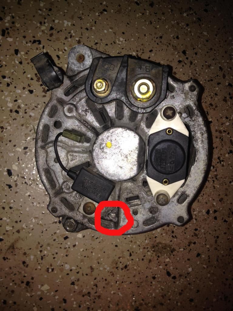

                The original picture and light reading. http://www.e30owners.com/forums/show...t=4446&page=17

                  uturn... thank you. I can't believe it. Pulled the alternator today, didn't see anything visual wrong, then saw your link to pic. Check out my alternator! I don't have (#4) ground wire at all!!! WTH? Could the PO lost it? Who would have forgotten it? Luckily, I ordered the wire kit from Gregs///M.
                  So, my question is = was my low readings due to the missing ground wire? BTW, the two wires (#2 in link) was properly attached.

                    The alt will ground though the bracket. Only used in alts with rubber bushings

                        That alternator certainly looks like it's toast. You can pull the voltage regulator out to learn more. Since the VR has already been replaced once, I am guessing that the slip ring is in bad shape and your best course of action is to buy a new (not remanufactured) or low-miles OEM one.
                        As stated, that later-style alternator grounds through the bracket.
