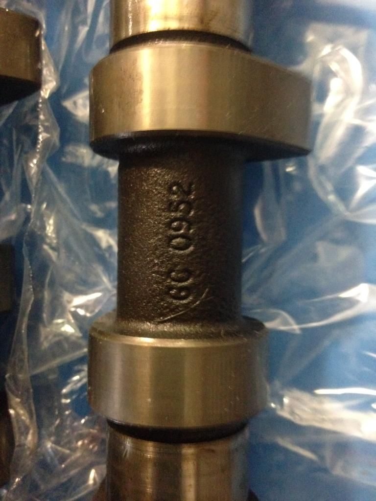

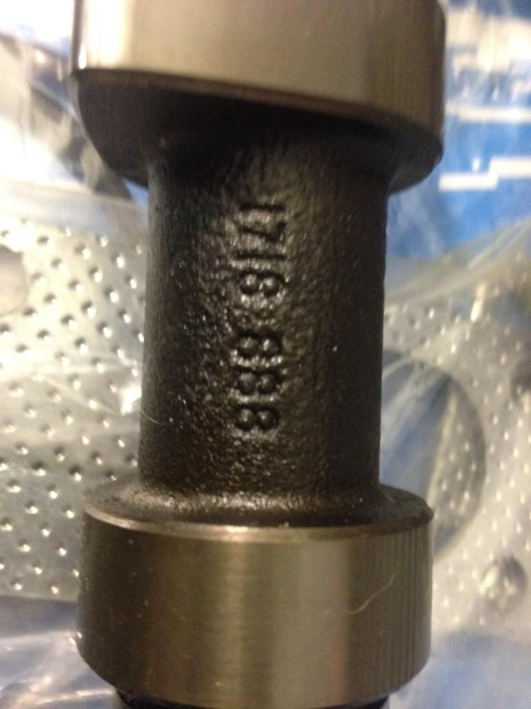

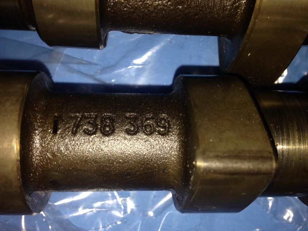

    I just bought a set of s52 cams and it just seems to me that they are not m3 cams compared to the m50 and m52 cams. Here are the part numbers on the cam that I found

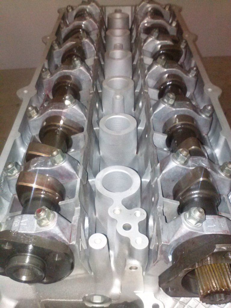

              I am 99% positive those are m50/52 cams. You can see the shape of the s50 cams in Pinky's build here...

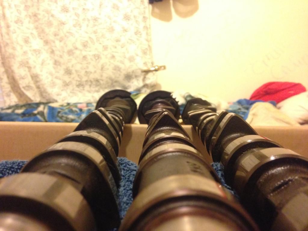

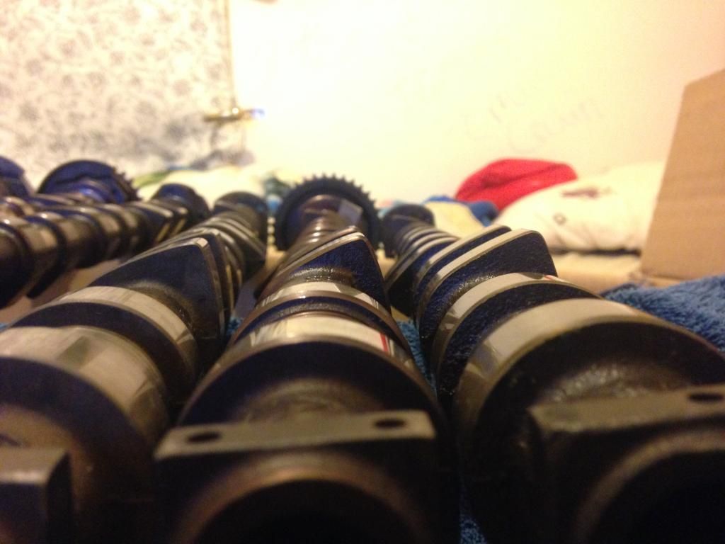

                  I'm about to go back to the shop and get my m50, m52 and s52 cams and take better pics to compare and post them up.
                    From left to right s52 m52 m50
                    This is exhaust side
                      This is the intake side. Same. Left to right
