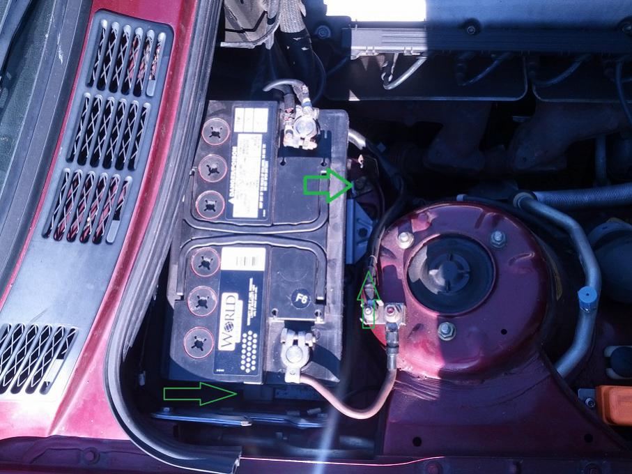

                            Finally got the parts. I'm not entirely sure how the space fits in but this is the only spot that seemed to make sense.
                            The bottom arrow points to the nylon spacer.
                            The middle arrow points to the bracket holding down the battery.
                            The top arrow points to some weird bracket that doesn't look factory and seems to be there to keep the cable away from the battery.
                            Does this look right to you guys?
