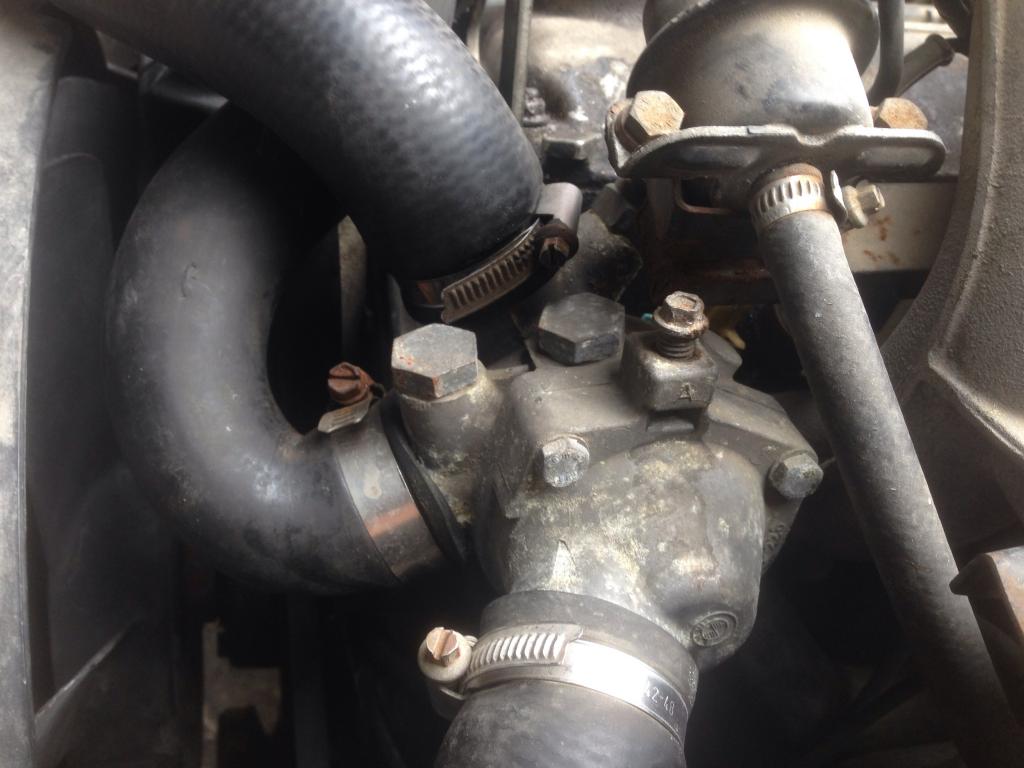

    I want to add an aftermarket VDO water temp gauge, but also retain my factory gauge (even if it doesn't work very well).
    Where is the best location to install an aftermarket coolant temperature gauge probe? I know it has to be IN the coolant flow.
    Upper rad hose adapter would only work after the T-stat opens, correct?
    I would think the T-stat housing would be ideal?
    These two "bolts" in the top of my Tstat. Are they removable? Can I just thread an aftermarket sender in there?
    Anyone know the thread pattern?

    Looks like they're either 12x1.5 or 14x1.5
    • Panici
      • Dec 2009
      • 2514
      Will they both have access to coolant before the T-stat opens?
      Also, are they deep enough for a temp sensor?

        I've done some searching, and it looks like Spec30 guys sometimes use those spots in the T-stat. Apparently it's an early cooling system provision, for ETAs that have four(?!) temperature sensors.
        I ordered a VDO Vision Black Temperature gauge kit, and it includes a 1/8" sender, with adapters for M12x1.5 and M14x1.5
        When I get the parts and install on the car, I'll update this thread for future reference!

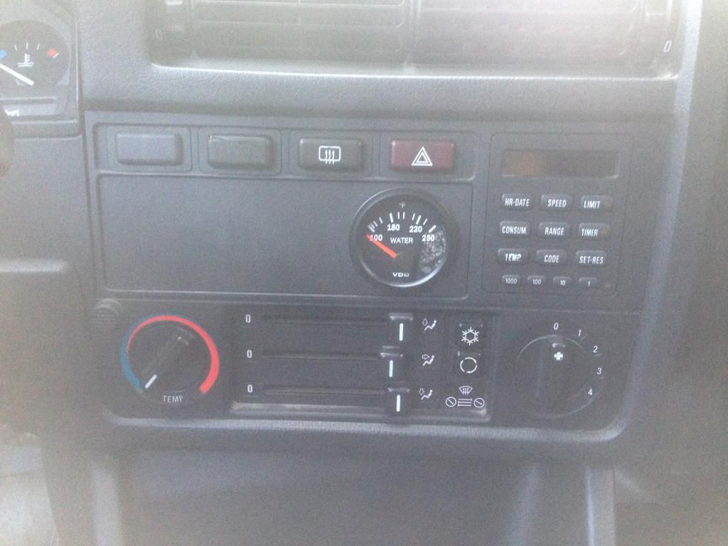

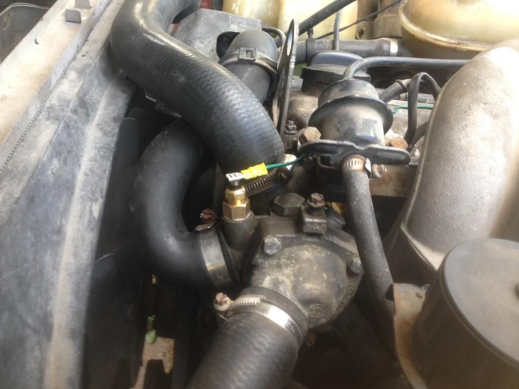

          Update.
          Got the Water temp gauge installed.
          I believe it was the M12x1.5 adapter that I used. Unfortunately they were not labeled.
          It's not the cleanest install, but when I add my oil pressure & temperature gauges, I'll be redoing the wiring.
          I ran the sender wire along with the factory harness, and under the intake manifold, with the factory coolant sensor wiring.
