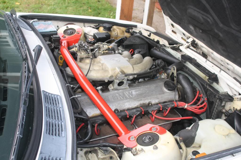

              On the Sparco brace they have indents where the studs come thru so the nuts have plenty of threads to grab on to..
              Here's mine on stock suspension.
              form.follows.function IG @mplfoster
                Sweet thanks! That's how my engine bay would look too, my car came with red spark plug wires. Perfect pic for reference.
