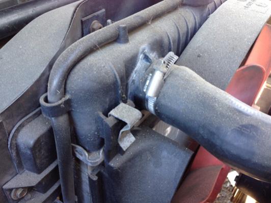

                    My old behr broke right at the upper nipple, seems like (from what I read) after about 100k the plastic gets brittle and fails. I don't know if this was the original, (which would make it about 250k) but I replaced it with another behr and trust if for at least 100k.
