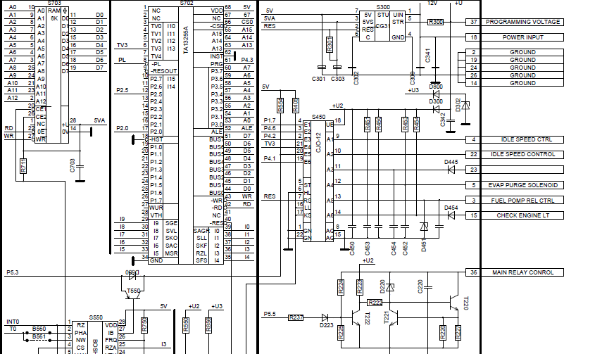

                DME diagram
                looking at a engineering diagram of the motronic 1.3 DME shows the pin 3 output for relay control looks to be shared with a chip driving the idle control motor ,purge valve and check engine lamp (does the check engine lamp come on?), might be worth disconnecting the IAC and purge to make sure one isnt shorting and bringing down the chip such that it can't run relay control. pin 23 also in the chip but no description looks to be the O2 heater relay control per the ETM so try disconnecting that relay also

                • AudioNToxication
                  • Nov 2013
                  • 117
                  Alright, thats a good point you make.
                  Ill try that.
                  I did notice during cranking i had 0 voltage on pin three. so thats a problem.
                  i had voltage on pin 1 until i cranked then it went to nothing.
                  So thats also odd.

                      interesting ,good find ,wonder if it will die if you plug in purge valve ,seems ive heard/read of issue's with purge valves in past but never one that stopped engine starting
                      pin 1 of DME is ignition control to coil,so that voltage will drop from 12v as DME pulses ground to fire coil
                      Purge is a pretty simple circuit power supplied to valve from main relay pin 1 and DME grounds second pin ,if valve was shorting power it should blow fuse for main relay which is a fuse link , but if it just shorted relay output you would loose power feed to FP relay control on pin 86 which also powers injectors and IAC per 89 IX ETM,might be different for 88
                      E30M3's had a recall for the purge valve sticking open causing dieseling on hot engine shutoff
