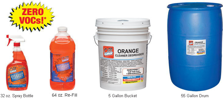

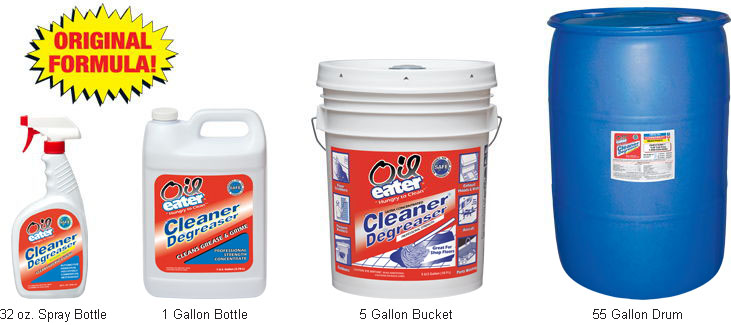

    What does the r3v have to say about engine degreaser products for a 20 gallon parts washer?
    I've long ago stopped using petroleum-based solvents, mostly for health and cracked up hands reasons. You get enuf carb cleaner and brake cleaner on your hands over the years and you just get tired of that nasty stuff.
    I've used "Oil Eater" recently - cheap from local parts stores. It cuts grease pretty fast and is not near as nasty as solvent, although it does have some smell in an open container. I use it straight, not diluted 1:1 as they recommend. I cleaned an E30 oil pan yesterday with Purple Power - worked good, but I read specifically NOT to use it in a parts washer.
    I've read all the forums where they talk about kerosene, diesel, mineral spirits, on & on… None of those things seem like a good choice in a closed garage where I have to breathe it and spill it on my pants.
    Reading about citrus-based cleaners makes them seem like the ticket - smell good, cut grease, water-soluble, non-toxic, etc. Most based on D-Limonene. Way more money usually then an Oil Eater, but you're supposed to dilute it. They are both "basic" vs acidic products.
    But I'm reading that the citrus cleaners are hard on hands, hard on the rubber seals in the pump, and hard on aluminum… This is a big concern as that's a lot of what I clean.
    Also, if these water-based things break down after a short time, that's a big expense to replace all the time. Solvent lasts a while even when gunky. I read that Purple Power breaks down pretty quickly and is bad for aluminum.

    I just got a note back from the customer service guy at Kafko International, which makes Oil Eater.
    He says the Oil Eater is the better choice than the citrus for a parts washer, and the stuff is much more effective diluted with water 1:1 than straight, which is interesting, and saves quite a bit of money. The water seems to hold the grease, oil , crud, etc. in suspension away from the part. I always used it straight, thinking it would cut faster.
    From Kafko:
    "If you use Oil Eater too strong, your parts will come out of the bath feeling slippery - add more water. When you have Oil Eater properly diluted with water, the water will keep the oil/grease/etc in suspension away from the part. Another benefit from proper dilution is that when not in use, Oil Eater will release the oil. The oil will rise to the surface. So when you turn your parts washer off for the day you can use a skimmer or simply put an “oil only” absorbent in the reservoir & the oil that has risen to the surface will be removed from the solution helping your solution last longer."
