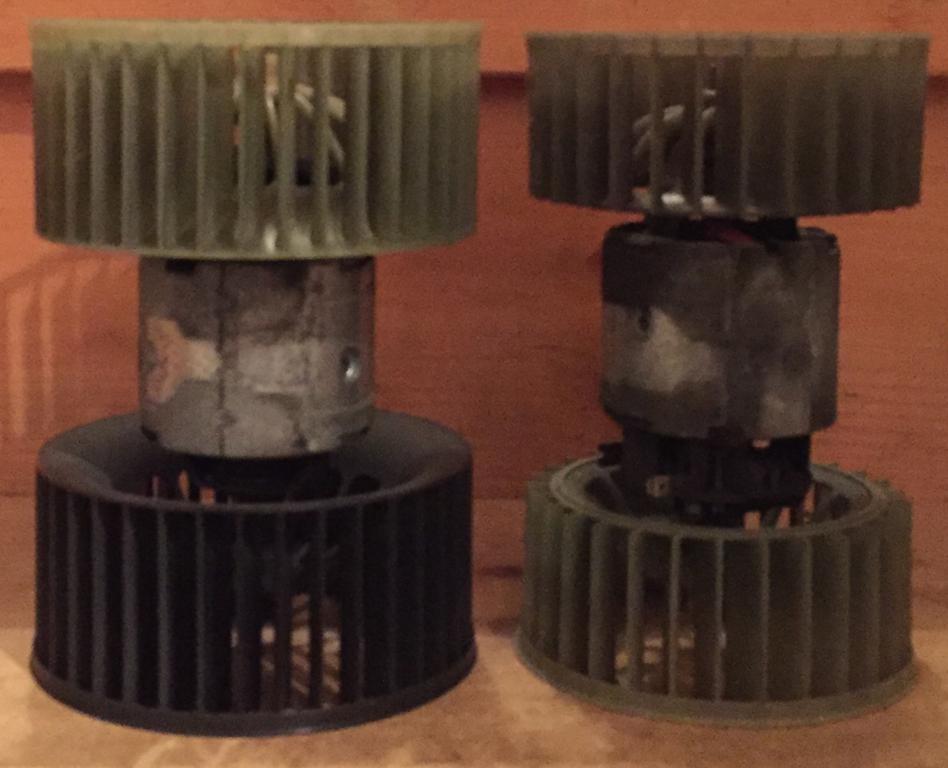

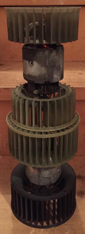

                          • ScentOfGasoline
                            • Sep 2005
                            • 1268
                            Originally posted by alpineE30
                            Does anyone know if a E36 blower motor would work in the e30 and not the z3 since its the same as the e30? I just wanted to know the dimensions of the e36 unit to see if its same or slightly the same thanks?
                            the motors appear to be the same but the wanes are different.. e36 on left/bottom resp.
                            • alpineE30
                              • Aug 2007
                              • 81
                              Thanks for the comparison. Now i wondering if the center body of the motors are the same diameter.
