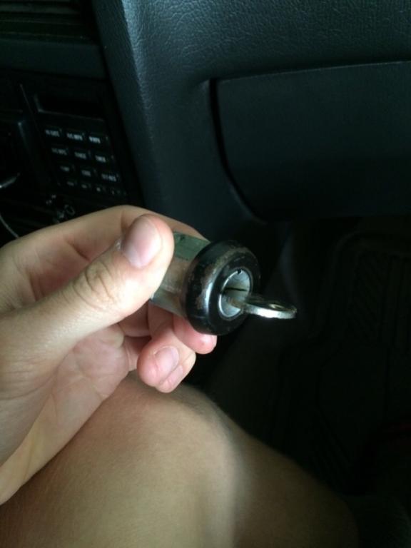

    When I was trying to start my car the other day for some reason i couldnt turn my key past the accessory position 1 (lights dont turn on but steering wheel unlocks) I thought that There was problems with the tumbler / key so i bought a new one off bav auto. I just took the old one out and the key now moves freely in all positions... Does that mean the tumbler is not the problem? Any help is appreciated thanks!

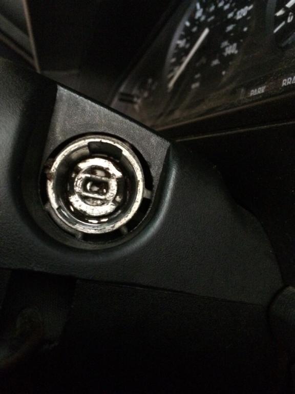

ID:	7177273 Also, should I be able to turn this with a screw driver and it will start? Because if so I cant turn it any farther than i could with the key...

              Don't seem that your tumbler is the problem since it turns all the way when removed. It could be the harness that is faulty.

                      pull the ignition switch (brown electrical part.held on with two screws or clips )off the lock assembly and see if you can now turn the part down inside with the tumbler removed, if it now turns problem is inside switch ,if not problem is in lock assembly

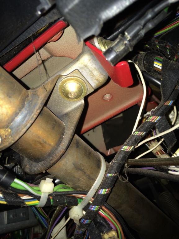

                          Thanks man. I tried taking it apart before I went to work and I couldnt get the steering column bolts off.. Click image for larger version
ID:	7177293 i think i might just drill them out and get normal bolts

                            That is a pita!! Those bolts are called "Shear Bolts". Their function is for the Hex/Torx or whatever head supposed to be there, to shear clean off when max. tightening is achieved. It is more of a safety thing so the car cannot be stolen easily.
                            1990 325i
                            2004 330i Individual 6-speed
