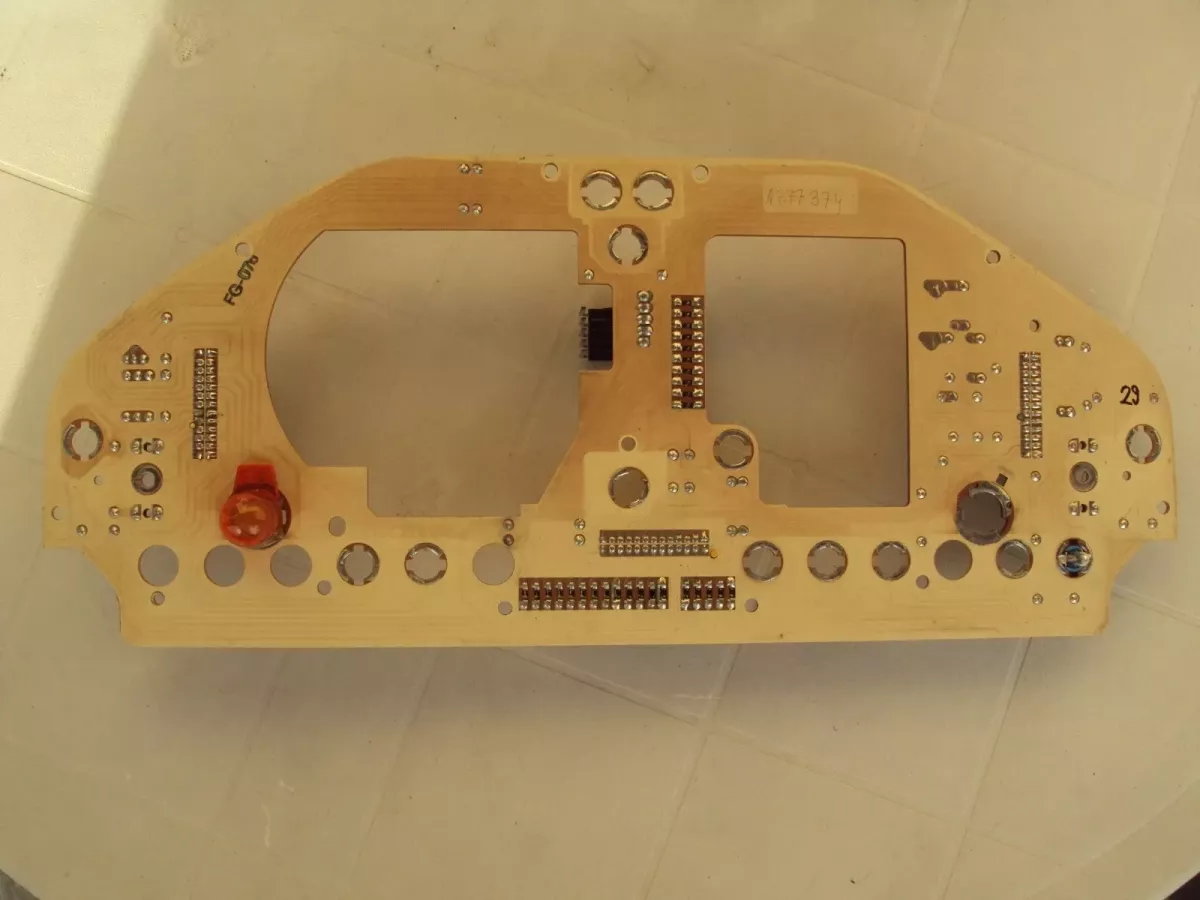

      You can replace just the PCB if it's bad.
      The later PCB can be identified by missing only 1 pin in the bottom connector.
      You can open your cluster and compare the board before buying.
      Click image for larger version  Name:	s-l1600.webp Views:	0 Size:	36.5 KB ID:	10156720

        Thanks for the heads up! That could be useful, but the problem is that most of the sellers in my area don't want to sell the PCB on its own. Any idea about the differences themselves?
        • Vincenze
          • Apr 2019
          • 1040
          km speedometers are the same for later cars.
          Tachometers are different for 5000 and 7000 rpm cars. You can notice differences immediately.
          Fuel gauges are 55 and 60 l. You can notice differences easily.
          Of course, US versions with miles are different.
          Later clusters all have code plugs in front.
          You can buy a cluster for a 4-cylinder 7000 rpm car and insert your coder.
