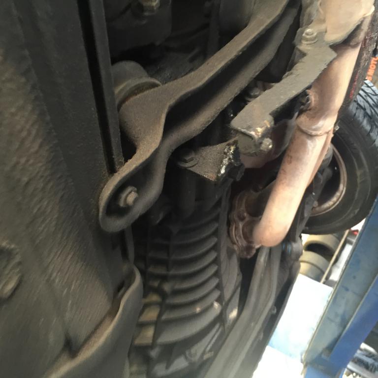

          So today I went to get my exhaust put on and I noticed this also. I contacted a buddy of mine over at BMW and he's getting me the parts to replace it. Maybe this could be it? Idk.

            The car drove great for the first 2 days without noise. That night though I hit something and it started doing the sound more. So I'm guessing this thing is flapping somehow and hitting something. Or the movements make it clunk around.

              Ok, I ordered that replacement part but I'm worried that it's not it. Today it did it LOUD, after not doing it for a day or two.
              The sound: It sounds like a motorcycle, or better yet. Put a poker card on bike wheels and ride around. It sounds like my e30 wished it was a motorcycle. Lmao. I'm leaning towards an axle being bad or on its way out but I didn't see anything wrong with the axle. And if it was that, wouldn't it be consistent?
