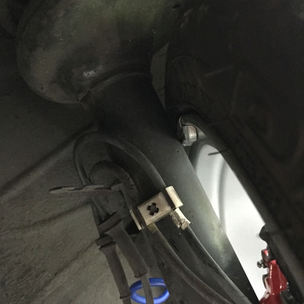

              Update and all fixed:
              Found two major issues that solved my problem. The passenger end link was loose and the nut wasn't tight to the inner sleeve. The other problem was a weight on the outside of the rim that would contact my strut housing.
              Surprisingly the weight only hit when turning and not going straight. One of my back wheels didn't have a rim weight so I just swapped them out with each other. And now no noise!!! While I was down there, I did the test mentioned above for the wheel bearing and glad to report those appear to be in good order.
              Not sure if this will help anyone else, but worth a read if someone is running Fifteen 52's or other wide wheels.

                  Yes very much so, however it was progressively getting worse and louder after my BBK. My best guess is the Rotors from the Corrado were a bit different offset and thickness than my e30 ones. Which ended up bringing in the wheel a mm or so. Enough to drive me crazy and think my wheel was gunna fall off! Lol
